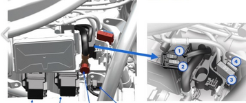

Great looking bike, jorgebri60. On a long cross-country trip to the eastern Canadian provinces from Texas last summer on my 2023 Pure, I encountered days and days of rain and fog. One day, after a stop for gas, the bike failed to start. I checked everything electrical, and finally discovered the battery connections were loose and the battery was not charging. I tightened both the positive and negative connections, and jump started the bike with a battery pack to get going again. But the battery would not hold a charge, so I ended up replacing the battery when I finally reached a dealership in Ontario. I hope that letting your bike dry out solves the problem, but definitely check your battery cables for tightness. Did you know there's a negative terminal for jump-starting that's directly beneath the right-hand cylinder?
I did not know that. Good to know 👍.
Have a look in the owners manual for jump start terminals.
Very handy for a generic battery charger indeed.
