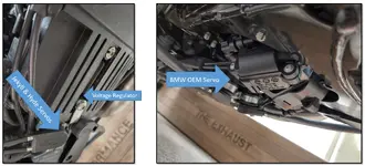

I just finished installing a Dr. Jekill & Mr. Hyde exhaust system; I did see the OEM exhaust servo motors during the installation. The OEM servo motors is located behind the Voltage Regulator; I did find a picture of the OEM servo motor on eBay: (see the below pictures)
