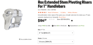

If the bar is 1” in diameter, I suppose this 4” Handlebar Riser will fit. Any experience about the wires? Do I need to buy new wires / cables because of the “new” height (4” more)

They DO sell taller risers on the BMW website. But, as usual, they don't give any information about what may be required in so far as wiring and/or hose changes that might be required. You'll also want to be sure that the add-on risers have the correct spacing to fit within the OEM parts.

I've ordered a set of universal riser extensions that the OEM risers will nestle on top of. They were only fitty bucks on the Amazon. Hopefully they will work....if not, yet another return.
