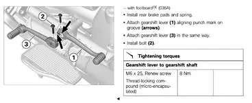

Unfortunately, I find it extremely difficult to upshift my R18 Classic. The rear shift peg is so high that I have to lift my foot off the foot board at least a couple inches to engage the rear peg. I keep missing the shift peg. I’m thinking the rear peg is mounted too high. It’s about 4” above the foot board. Is this normal?

Super easy to set it where you want it. Pull the bolt, slide the lever off, slide it back on, replace the bolt.
There is a page in your manual that describes it.
I lowered mine as well. Made a world of difference.

I had some shifting issues with the floor boards as well. The pegs seem a bit short and the positioning can feel awkward. You can buy "extended" shift pegs from wunderlich for both the heel shifter and the toe shifter. Then you have the option to try and position the toe shifter so it can be pushed up or down and ignore the heel shifter. Alternately, you can loosen the set screws on the shift levers as MengerFan mentions and pull them off the splined shaft and re-adjust them to a lower position and try that.
Just be careful on the heel shifter, you can set it so low that it is tapping against the exhaust shield so make sure it has clearance. You dont need much but it shouldnt touch on a full down push.

I really like the boards and wasn't having too many issues apart from missing the occasional downshift which I put down to me being new to the bike. The heel shifter did feel a little high but was easy to find.
I removed the shift levers to lower them, but the heel shifter when lowered was hitting the seam on the fishtail exhaust. As a result, I reversed the shifters so that the heel shifter now sits on the outside (which is how HD have them fitted) and was able to lower it clearing the exhaust, this also pushed out the shifter peg itself. Lowered the toe shifter and it also now sits slightly further in. Had a long ride yesterday and the difference in shifting experience is remarkable tbh, feel like I have a lot more room above the row shifter and the heel shift is even better. I recommend others with boards try this first before spending out on the extended pegs 👍🏻

Great idea about swapping the toe/heel positions. I wanted to lower my rear shifter further but it also hit my Classic exhaust. I'm going to give that a look.
