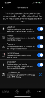

Can you verify that you have MPH selected within the App Settings:
Yep, set to miles. There’s a recent review in the Apple App Store citing the same issue. Would imagine it’s widespread but the update pushed when a lot of us put the bikes up for the season.
