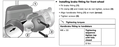

What is the torque value for the clamshells that hold the clutch,mirror reservoir/ brake, brake reservoir, mirror? What is the process for tightening? For example my Softail you tightened the bottom screw first then the top.
