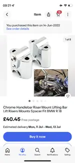

I also purchased mine from eBay. As many have said, the actual radius of the area that is supposed to mate with the bars themselves is smaller than 1", such that the risers contact the bars effectively at four points (two per riser) as opposed to being a nice even fit. I ended up putting mine in a vice and milling them to fit a 1" OD pipe wrapped in sandpaper. It took about 30 min of time and sweat but it made them fit without that nasty gap.I have the ones from EBay and am pretty happy with them. Definitely more comfortable for me. The components arrived with no instructions but were of a decent quality. The fit did not appear to be 100% fit around the bars but they are very secure.
Ideally I would like an approved part but for the price, the eBay ones are very good in my opinion.
