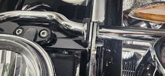

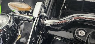

I ended up buying these inexpensive vacuum caps from autozone. They push into the holes and rattle is gone. No tools or bolts to mess up the chrome and if I loose one, oh well. They come in a pack of 8 and I have yet to misplace one.
