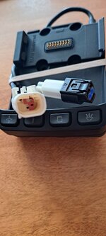

When I got my 2022 R1250GSA, it came with the cradle for the BMW Nav VI. When I bought the Nav VI, it came with a different cradle.
Question : If I mount this cradle on my 2022 R18 , does any body know if it will plug in and where would that be at.

I'm not sure there is a spare switched accessory socket on a TC but I could be wrong. You can tap into the accessory power socket up there on the left side of the dash. Wunderlich sells a plug in adapter if you don't want to cut into the harness. It's quite easy to access the back of the socket once you remove the screen and top dash cover. I just installed a Garmin XT2 mount and used that supply to power it.
