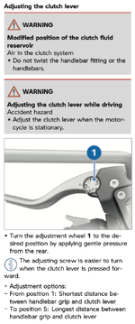

Had the bike in for the reverse call. Figured I’d let them do the annual service since they’d have it anyway. Well, they installed the new brake and clutch levers as part of the recall perk and messed with the friction point of the clutch. I can dump it in first and it won’t stall. Feels like I’m riding a 50cc bike, as the friction point is all the way at the total open release end of the lever now. Just revs out with barely any forward motion at like 4,500-5000 rpms.
Does anyone know how to adjust the friction point? Never fiddled with hydraulic clutches, so no real idea here. Any help is tremendously appreciated.

Thanks for the response. Looks like bit 5 is a spring which sits against the aluminum thing that holds the pushrod.
I took the lever off the bike to get an idea of how it was put together. Now what I’m not sure of is whether the pushrod is doing what it’s supposed to do. There’s an adjustment screw, but I can barely get it to do anything before it stops moving. The shop will do pick up/drop off, so I’m probably best just having them scoop up the bike and make it right.
