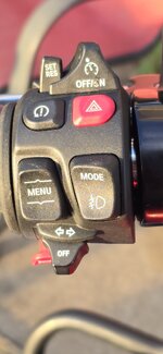

My cruise control on/off switch thing has come off. Is anyone familiar with how to reinstall (verbage?) the switch?

The cruise control toggle removal happened somewhere in that madness. Not sure how, but none of the bits seem to be broken. There just has to be some sort of odd trick to installing it.

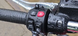

I did end up super gluing the switch. Upon further inspection, half the tabs that hold the switch on had been broken off. The framework the toggle switch mounts to, to make a long story short, just wouldn't allow you to simply dab on some glue and apply switch. Also, because half of the mounting structure was broken off, I had to do something about reinforcing what remained.
In the end, I bought some superglue and got creative. I found the smallest bit I had on hand to drill out a couple holes in both sides of the toggle switch and made corresponding holes in the mounting tabs that remained.
I broke off two 3/8" pieces of the drill bit I used to make the holes and used them as retention dowels. Hid the hole and dowel as best I could on the front side. I was limited by where the remaining tab remained and tried to hide my hole in the "o" as best I could. Because there is a ball bearing on the bottom side of the switch used as a part of the built in detent mechanism, you couldn't simply drill all the way through and use a single dowel, I had to also offset a second dowel on the back side of the switch.
I also used some super glue for good measure but had to be careful not to gum up the entire slide mechanism along the way.
Seems to work. Better than trying warranty service or buying a new left commando unit ($400USD second-hand, if lucky).
