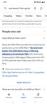

So then this is a lie?

So this is a lie?

So this is a lie?
There are a lot of words there.... so hard to say..... I'll be nice and call it their version of their truth.... (if we were talking in person I probably say ... xxx)
Of course they sell their filters.... that normally is the place you go for marketing talk.... not well researched data driven fact base on a particular topic.
Engine filtration is a complex thing.... things like particle size getting by the filter, where the filter is in its service life etc.

a quote "Traditional cellulose filter media used for air filtration in vehicle engines are characterized by 99.9% filtration efficiency and accuracy above 2–5 µm".... so did DNA lie when they said "97-99"?...I'm sure they will have some record of one that tested at 97.... maybe a bike some years ago from china... or india.... (maybe I'm being too cynical... )... truth in marketing is easily found/made..... (I was once a media spokesperson for a large national company... so I know how it goes).
If someone said to me an oiled cotton filter is about 98% effective.... and a OEM is, on average 99.5%.... that would sound ball park.... I run a Donaldson Powercore filter in a special airbox on my land cruiser that they claim is 99.99%.... it's based on the high end stuff used on earthworks machines..... and about the upper limit of filtering.... but need a new airbox as well.... and cost a lot.... for o.4% gain.... but a motor is $30k or so... and I have to drive at times in dust storms.... and I hope to get 20 years running out of it.
