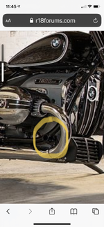

Can anyone help me out with the dimensions of these 2 spacers for DK bars if you have them?
Unfortunately they were missing when I received the kit, hoping to source them locally if they're a generic part. I assume they would go by fastener size (ie M12), outer diameter, and length
The larger of the two is the same length as the depth of that larger frame mount hole. This one:
It’s a M12. But you’d need to remove the bolt (with the engine supported) to measure it’s true depth. Diameter-wise, it just needs to fit into that space.
I’ll try to measure the smaller one when I get home from work.
I had a heck of a time trying to get my caliper in position to measure the smaller spacer. The best I could come up with was 46.3mm which doesn't readily convert to any typical fraction. Also I noted that the larger spacer pushes the plate away from the large engine mount socket (circled in the photo) about a mm or 2. In other words, it's not flush. Which is probably a good thing. Hopefully someone who ordered the bars or who is taking them off for some reason, can chime in with exact measurements.

Alright. Got your measurements Sqeeps.
Big Spacer
length 54 (end to end)
diameter 32mm
M12
BUT there's a little wrinkle. The cylinder has a 2mm cuff at the end which has a diameter of 24mm.
Smaller Spacer
length 45mm
diameter 20mm
M10
it's black by the way
Hope this helps!
