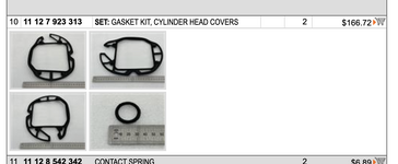

Valve cover gasket...
Inspect, clean and replace if needed.
Its $350.00
David
That's an expensive piece of rubberized plastic... My BMW service manager said that the gasket doesn't typically need to be replaced as suggested at the 6k mile service interval; depending on your miles, perhaps it's time for new...
That's $700 for two gaskets... crazy...
