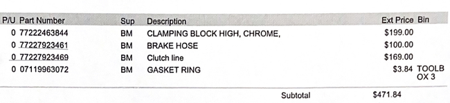

I look forward too to have them. The dealer told me they are in back order and will not reach the US until December 2022. I also have the specific clutch and break line codes for this riser if anyone wants to have them.
