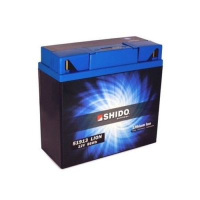

800CCA Battery? What brand and model? Is it a direct fit, same physical size and terminal placement? My 2021 R18 Classic seems due for a new battery.
Yes, direct fit factory replacement - same size as the factory battery.
Antigravity ATX30 RE-START Lithium Battery
