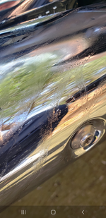

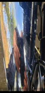

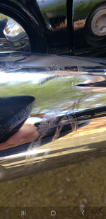

I have 809 miles on odometer. I'm changed oil 150 miles ago, used 4 liters of original BMW advantec pro 15w50 oil and filter. I have a good oil level ,exactly on the middle, when engine is hot. When I had a short ride on Christmas, I'm started feeling smell of oil and I found oil on the right side of the bike...(((
Some pictures of leaks...

A few drops of Oil can appear as much larger amount.I would pull off the chrome cover and see if you may have gotten a little on the outside of the filler hole.The dealer did my first oil change and there was a small amount of oil in the ring bottom of the oil fill hole.
Hope that helps...
