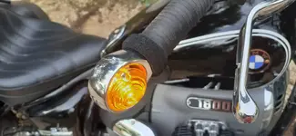

I was wondering if anyone found / changed the front indicator lights on R18 Classic . I am changing the back ones with the number plates side-mount from Wunderlich, but I couldn't find ones for the front.
Thank you ,
I have changed front and back on my bike. The front picture of my bike shows how hidden they are as they are only about 3/8” in diameter. The front I used Kellermann ATTO mini lights up front. Very bright and you don’t know they are there. Just buy the lights, no other hardware necessary except to solder. They mount to the existing bracket very well.
As for the back, I used Kellermann Bullet 1000. I needed plates to mount the lights. I had the plates fabricated and used the Wunderlich wire harness. Solder all your connections with the harness because the CANbus system does not like weak connections.
The Kellermann products are very high quality.
Good luck!

Here are two better pictures.

Thank you, The front lights looks really good , as you said , hardly there. I have the bracket from Wunderlich for the back light with the number plate side mount. Thank you again.
