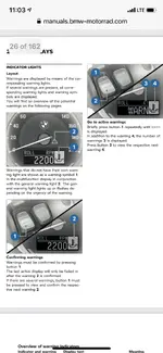

When scrolling thru the menu on the speedo I noticed warn code 1! What does this mean? Just got the bike Saturday. Sorry if this is a dumb question...
Could you attach a photo? Confirm the warning as described below. The “1” could just indicate the number of warnings or that it’s the first warning. And don’t sweat it too much, the reserve fuel indicator comes up as a warning

The wrench is the service reminder.
It can be rest with the GS 911, once the updated software code is available.
