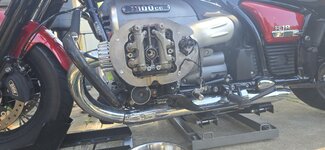

Left side valves adjusted. Just washed the valve cover gasket. Reassembling and starting on the right side as soon as the reply button is pressed.
Edit/update:
Pre-adjustment, the right cylinder was quite noisy and I expected a bunch of slop on the valve. Started with the left cylinder, finished with the right.
Dunno what I did to the left, but somehow my left exhaust valve adjustment was way off. Had to double back and re-adjust. Didn't rotate the engine/cam lobe over and double check before closing the head back up...should have know better. Somehow ended up around to .40mm on the exhaust side. Honestly only added 10 mins to the whole process.
.2-.3mm....I went with .23mm.
