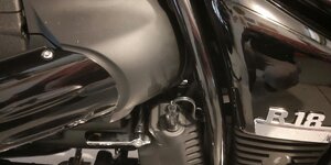

There is the power plug ... you have to unplug the connector to the utility outlet and then it plugs in between the supply wire and the outlet ... the other (brown) wire was too short the way I routed the wire that goes to the spark plug ... I had to lenghten that one and while I am at it I ditched the red 'squeeze' on connector ... stripped a short piece of the brown/black wire at the sparkplug and soldered it on ... not too difficult, but yes the instructions are a bit 'lack luster', I hope this helps.

- New brake and clutch top lines (w 5 cm pullback)
- Wunderlich tachometer. It fits Classic windshield! They have changed the original design of the base.
Notes:
The top lines were stretched so decided to buy customized lines from Spiegler - you need 2, both are going to be 375mm long ( center to center) and we are using a 20° lateral bend banjo fitting on all ends of these lines - probably you want 370mm as you can see mine could be a bit shorter.
Lines were under 130 USD which was AWESOME in price and quality. Call Brian, and he can help.
Brian Hart
Sales
Phone:937-291-1735
No need to bleed lines, just follow instructions found on this forum for the beach lines, wunderlichs just recommend you to pump and pump… brake lines is easy, clutch takes 30 mins of pumping
For clutch you have to buy BMW Clutch Fluid which is blue!
Tachometer is much cheaper in EU. A friend was visiting France and saved some money. Brown wire is too short to follow other wires so i extended it.

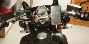

Yes the tach most certainly fits ... I just installed one too and the bracket looks much different than the one shown on the American Wunderlich site ... I was perfectly prepared to make a bracket after they told me that it wouldn't fit ... But I didn't have to ... Nice ... One question, does the back light on yours also stay on for an extra 30 seconds after you turn the bike off? Not a problem ... Just a bit odd.
Yes it does! Also lights up when i am charging battery using Can bus enabled battery tender.
