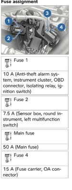

Also when engaging reverse my R would flash and not engage reverse when pushing the starter.
I had done some fiddling with the wiring for some accessories and had read somewhere that it could be fuse related. So pulled up the fuse info and decided to check the fuses.
First fuse I pulled was #4 the 15 amp. It was toast. Now I had no other issues only the flashing R and reverse not activating.
Replaced it and R stopped flashing and reverse now working.
