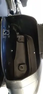

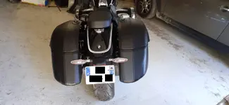

I wanted lockable bags. Yes, we are in south of France ... :sneaky:
So I found this:
https://www.motea.com/en/motorbike-...-case-incl-mouting-brackets-in-black-966266-0
I like he "stream line" design of these cases.
And the material is of good quality, matching the general aspect of the bike.

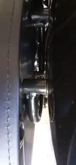

I made a card board pattern to figure out where to position the holes on the inner side, and make sure of the symmetry.
I used the BMW supports, but strangely they are not identical. I'll have to machine the port side to reduce the gap.
