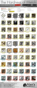

I got an email that this thread was being responded to again. I'll reiterate my previous comment that 0000 (QUAD, four zeros) steel wool works WONDERS on chrome (aka: chromium). The lubricant isn't as important, but IMHO, I wouldn't use steel wool on chromium dry. I could probably google a study between wet and dry and post it here, but there's an old quote about giving a fish or teaching to fish....
A good visual guide to the Mohs scale of hardness shows that steel is softer than chromium (steel's hardness is 4.0, chromium is 8.5):
Source: https://alansfactoryoutlet.com/info...-scale-a-chart-of-the-mohs-scale-of-hardness/
And, a good visual that shows the benefits of 0000 steel wool on chrome surfaces:
Mike
