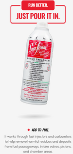

Any R18 owners using the Sea Foam product as part of their annual R18 maintenance routine; if so, which specific product, how much and how often?
The below product looks like it's designed to be added directly to the fuel tank, in order to target fuel injectors.
Added to Fuel Tank?
Added to Engine Oil?
Sprayed into Air Intake?
it is mainly snake oil.
Even on direct injection which has more issues with fouling of intake valves, injectors, misting H2O with the engine running on high idle is basically as effective.
It is thus best done when the air filter needs be replaced. You can the mist it into de air box.

seafoam was made for 2 cycle outboard motors somehow people thought it worked good on 4 cycles. in the us or Canada try www.pure-gas.org .the only additive I've ever used is Techron made bt chevron oil.stuff work wonders.
If you are going to use an additive - use one that has PEA (Polyetheramine) in it. There are quite a few that have this. PEA is well proven to clean fuel injectors as well as carbon buildup on pistons, ring lands, heads and valves. Sea Foam is an OK additive but any additive with PEA is far better. Sea Foam is a decent fuel stabilizer though.
