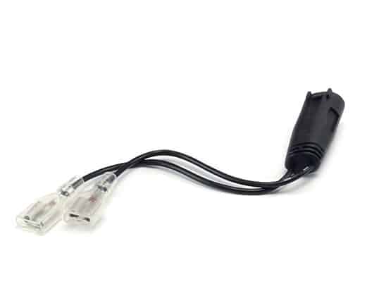

FYI. BMW harness.
Denali Wiring Adapter for Connecting SoundBomb Horns to OEM BMW Horn Harness | Adventure Moto Austra
Denali Wiring Adapter for Connecting SoundBomb Horns to OEM BMW Horn Harness from Adventure Moto Australia. $10 shipping Australia wide. Shop now!www.adventuremoto.com.au
