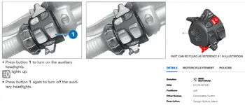

Thanks! I'd have to think about the aux lights, not sure if I'll add them. Mini-blinkers seem cool also. So you use the 12V socket for the switch? Is it not possible to use the switch on the bars? I think I read somewhere that while the bar button doesn't have indication of the lights, it's still possible to connect the cables and use it?
I had removed all of the front fairing pieces, in order to expose all of the wiring necessary for the directional and auxiliary lights (The B model appears to be pre-wired the same as the TC model); I didn't have any luck activating the Auxiliary Light wiring sockets via the Model B control tree "Mode" button. I did price out the cost of the TC Left-Hand Control Tree, it was $577; however, there wasn't a guaranteed that the TC switch would even work on my Model B, due to the CPU being mapped to a B model vs a TC model.

Scott ... I had aux lights added to my plain FE and my toggle button does not show the light symbol but the switch does turn the lights on and off .. mine were installed by the dealer, it was part of the package that I had haggled out with them ... after the mechanic told me that he was blown away that all the functionality was already there, without having to change the controls .. next chance i get, I will ask him if there was something in the ECU/Software that had to be enabled to make it work.
I thought I had briefly checked the OEM switch for that functionality on my Model-B when I took on the auxiliary light project a while back (now I'm not 100% sure I did); perhaps, if I get to a point where I want to change my setup - I'll have this as an option. So far, I've been really happy with my setup and the switch looks like it belongs on the dash; plus, the switch lights up telling me that the auxiliary lights are on.
I'm not sure if the TC has an auxiliary light indicator on the TFT screen, telling the rider the status of the Auxiliary Lights (ON/OFF)?
The FE does ... it is a green headlight looking symbol that lights up when the Aux lights are on ... so I would think the TC with the much larger display would have it too ... and good on you for the switch! ... and if it ain't broke don't fix it ;) I will still ask the mechanic .. I should see him tomorrow ... maybe somebody else can benefit from that info.

Yup! TC has a green icon for the aux lights, blue for the high beam..
Ask the shop, perhaps there is another connection that I need to make; similar to what you had to do under the gas tank. If so, perhaps I'll take a stab at it on a raining day when riding isn't an option; if not this Summer, it would be a great Winter project. Any additional information would be greatly appreciated; if so, I can restore all of the wiring back to stock - including the 12 V accessory outlet.
